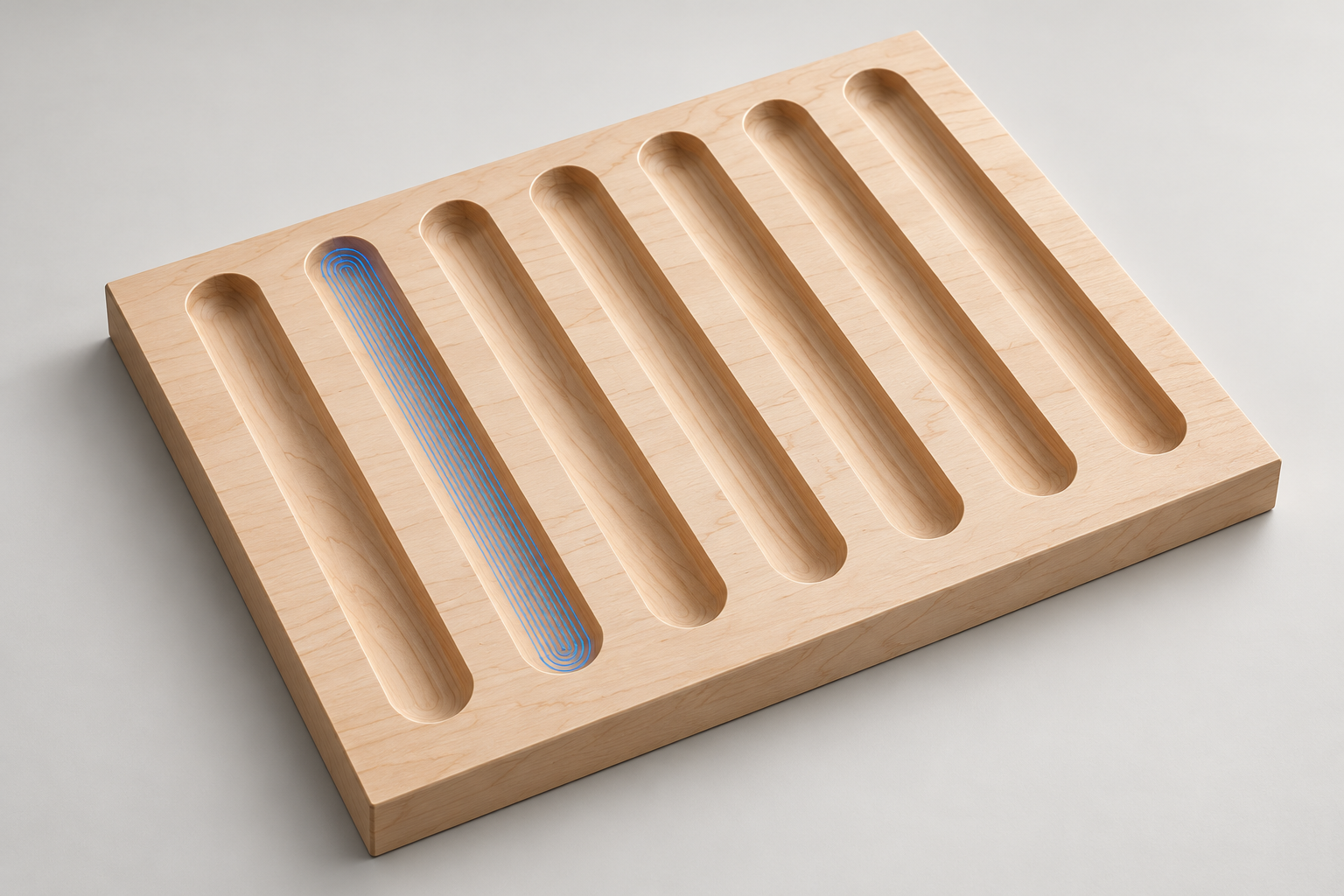

This gadget will create vectors for a Fluted panel. All you have to do is specify the dimensions.
How It Works
This gadget works by taking your dimensions for a fluted panel and automatically create the vectors needed for you, you then need to use those vectors to create a toolpath to create the desired effect on CNC.
Step By Step
To use this gadget just follow these simple steps:
  1. Start a new job in Aspire or VCarve Pro
  2. Go to "Gadgets" on the toolbar and select the "Fluter" Gadget
  3. With the Gadget running you will have the following options
    • Anchor Point: Specify where on the job to create the vectors
    • Length & Width: Specify the size of the panel to create
    • Number of Flutes: Specify the number of flutes to create across the panel
    • Start & End: Specify how far into the material to start and end the flute
    • Flute Width: Specify the width of each flute.
  4. Click "OK" to use the specified options and the Gadget will now create the vectors to use to create the toolpath.
