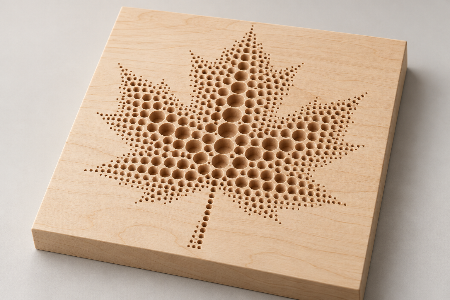

This gadget can be used to create some stunning halftone effects from your home photo collection or any designs you may have and then machine them on CNC. Note: This gadget is only compatible with Aspire.
How It Works
This Gadget creates this effect by drilling holes at different depths with either a V-Bit or Ball Nose Tool, The darker the colour, the deeper and wider the hole drilled.
